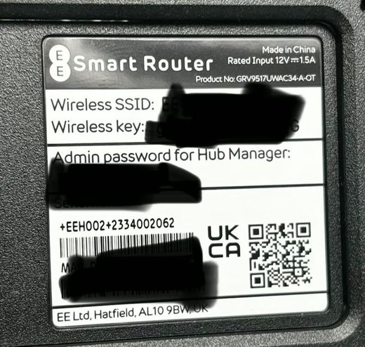

You don't specify which model of SH you have.  What is the name of the EE BB plan you are on including its speed? Which EE router & WiFi extenders, if any, do you have (read label or post a pix)?
Apologies, I need a static IP on our home network for the devices not for the main modem/router Smart Hub. Our broadband plan is fibre broadband without landline and a speed of approx 40Mbps. We use Deco 5 discs to improve the signal as its a three storey property.
@Oakdene19 : You have the (white) Smart Router, not the (black) Smart Hub.
