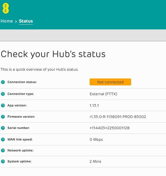

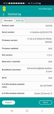

@Ewan15 I've got home and restarted the router, still orange flashing light. I've taken a screenshot of the box info for you..

You were asked for the initial Status page not the Tech Log. The former reports the status of the BB connection the latter only facts about the router.

I'm surprised not to see a WAN Link Speed entry.
On FTTP a disconnected SH+'s Status should look like:Capture.JPG
