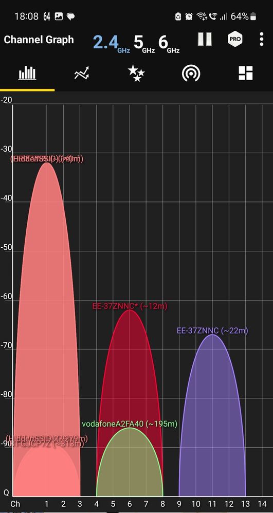

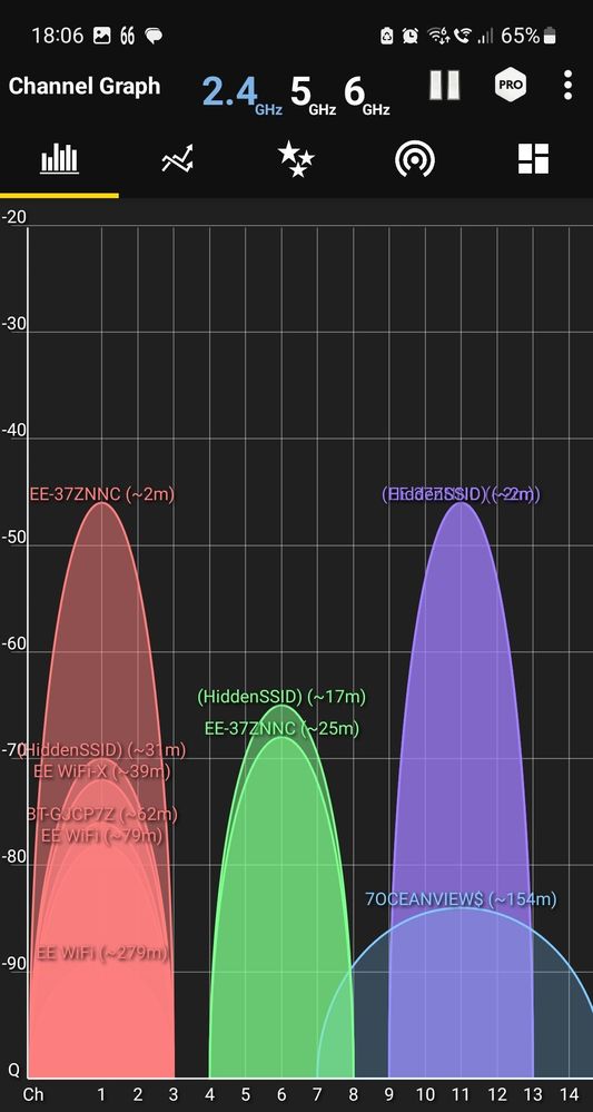

Downloaded WiFi Analyser ..... 2 screen shots attached for 2.4GHz
The first inside the house the second at the device locations in garden.

@Posiedon Are you on android, the bars show a 6 when connected to the 5Ghz band or no number when connected to the 2.4Ghz band.
Netspot by Etwok, inc on the google play store, shows everything, but do just use the Free version.....
Not allowed on ios for any...
