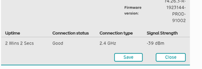

Secondly, , is it expected that the extender reports 'Connection type: 2.4 GHz' when wirelessly connected to the hub, or should the backhaul normally use 5 GHz under good signal conditions?"
No matter how close it is to the hub, it only connects at 2.4, which only give about 10-20% of the broadband speed.

@JimM11 so both the SH and SW output 5Ghz to the devices, and I can see on the Hub web interface what devices are connected and either 2.4 or 5Ghz.
The main issues is that the SW's on connect to the SH via 2.4Ghz, which as a result has slowed down the speeds, and this is regardless of how far the SW is from the SH.
I'm on Full Fibre to the property. The SH router outputs around 900mbps while connection to the SW is around 100mbps.
(this is the SW's connection to the SH)

Although this is a picture from the BT Complete wifi unit i did, can you do the same and post up like the example all your Extender page capture, be sure to hide the ssid's mac etc to get it through for viewing. You will see it is connected on the 5Ghz band but the owner only had a FF150 connection and i had no access to the BT Hub to run a full speed check Extender / Hub, but the 150Mb/s was not an issue and sync was 866Mb/s up/down to the Extender.

@Jimbuck999 Your picture is cleared now, your extender at -74dbm you are way to far from the EE Hub distance wise, or something is messing with your wireless wifi signals, do you have ANY other transmitting devices, Range Extenders, Sky Q boxes etc with wifi turned on as old hotspot's...
Hi @JimM11
45383.pngIt really doesn't matter how close the SW is to the SH, it's only taking at 2.4, and therefore maxes around 100mbps, sometimes as low as 10mbps.
There are a few WiFi bits around, a few sky boxes, and a wireless thermostat hub. Those with plugs removed have made no difference.
Half the battle is the mesh as well, as while still connected to a further point, it routinely says no Internet so have to turn off WiFi and turn it back on, on the device for it to connect again.
