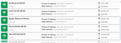

As for connected devices, among those that I recognize, there are these ones with strange names:
But I am very certain those are devices of other tenants, since I am not living alone, and each of them has multiple devices connected. So not really suspicious, unless you have a different theory?

[Mod edit: Please do not post MAC addresses on the public board. Thanks!]

You may be able to ID these devices using MAC Address Lookup
Thank you! Although I could only identify two of them, a samsung device and azure technologies, which I know of.
