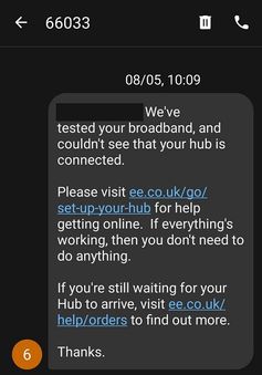

...I also received this sms recently; I don't think they're liking us 'legacy router folk' much, they can't see us properly! 😅

@MBEE Just maybe that EE are trying to match the serial number off the router that they may have sent you, and what are you currently using?
