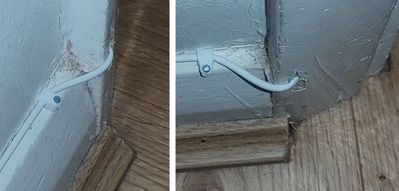

The only other thing I'm a little concerned about every time I walk past it is the way the engineer routed the optical cable through this wooden, internal door frame by the skirting board. He assured me it was ok but it's a delicate cable and am kinda worried that it's been left vulnerable to a knock from a passing foot / hoover / whatever...
