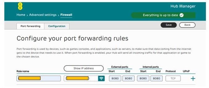

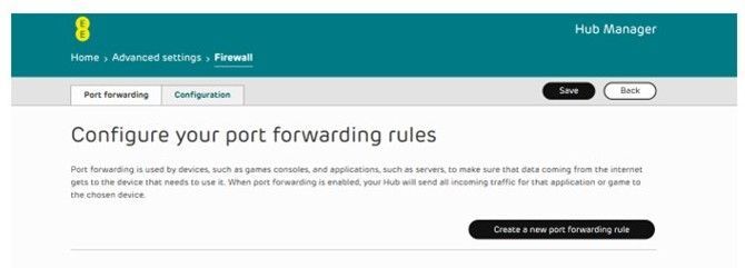

The main issue I am having at the moment though is port forwarding. The port I forwarded worked fine on wifi 6 and worked fine on last week's smarthub 7 pro. However, when I create it in the admin/advanced pages and save it then go back out and come back in again it's disappeared, isn't showing and doesn't appear to be working.
Any ideas if I'm doing something wrong? As far as I'm aware I've done the same thing as I have previously when its worked ok

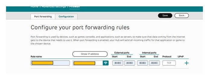

Have you tried creating the port forwarding rule then clicking the + (plus) to create a second rule but not actually entering any data in the second then saving? It is the only way I can enter a port forwarding rule.

I've read through everything and unless I don't understand something, nothing on any of the other threads seems to address the issue that I am seeing.
I can go in and create a port forwarding rule
I then save it and everything looks fine
It doesn't work though - and if I go back in and check, the rule has disappeared, putting me back where I was when I started
This exact rule worked perfectly with my wifi6 router, and worked ok with the Smarthub 7 Pro router I was originally sent (I was sent a replacement as the extender wouldn't work - it still doesn't so I'm getting another one of them delivered).
I saw posts about Windows firewall potentially causing issues so tried it with it disabled and had exactly the same result. I've reset the router as another post suggested. Same result.
Really don't know where to go from here
05-03-2026 12:56 PM
I hadn't tried that but I did and guess what? It worked! Brilliant - thanks for that
05-03-2026 02:16 PM
You need to 1st press the '+' to the R of the rule before it becomes operative. Then you can "Save" it. It would've been the same with your earlier routers.
