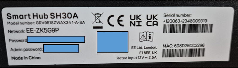

@davidwf15 wrote:
re-connected the ee smart hub 3
No such beast! Which EE router & WiFi extenders, if any, do you have (read label or post a pix)?

My apologies, it is a SH30A, new a couple of months ago
Wifi turned off in the ee router, I am using my existing MESH network comprising 3 x BT discs all connected via ethernet cables

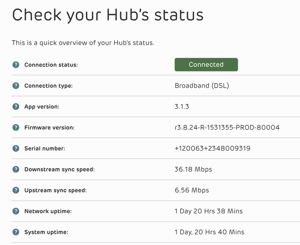

What does BT Wholesale Broadband Availability Checker estimate for your phone number? Post the whole table and the line above it, blanking out your phone number. If it doesn't recognise your phone number or you don't have one, use the Address Checker.
When you are using the BT SH2 what does it report as the Speeds, Attenuations & Noise Margins  (or SNRMs)?

@davidwf15 You may wish to check information on the Forum off user's posting's where the whole home wi-fi was problematic connected to the EE Smarthub+ Router and only moving to the smart wireless for the Plus fixed the issue. If you are finding the mesh is working ok then just ignore!
Profile closed
Not applicable
would you be kind enough to advise how I do that
thanks
