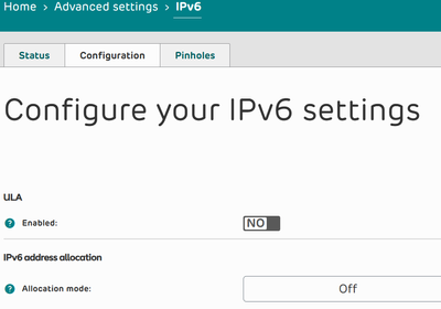

I initially accepted but today cancelled that pointless exercise as, thanks to my long suffering tech guru we found that tracert and pings were super slow and he noticed that the results returned indicated an IPV6 connection....after turning that off in the router all pings and tracert commands are returned quickly and pages now load blisteringly quickly as they should!😀
This is the setting I turned off, I also proved that with it on, page loads were troublesome and turning it off again they were fine so hope that might help other people with similar problems

@davidwf15 Replacement EE Router would not have made any difference, not 100% sure if the BT Smarthub2 is iPv6 enabled by default you would have to check, www.whatismyipaddress.com will return both if it does.
Turning it off for you if that works then fine, but would be looking at what you have hanging off the router to see why iPv6 is not working that way. BT/EE have had it on and working for years but some devices do come across issues!
From what i can see on the limited screens for the BT Smarthub2 that i have iPv6 is in the advanced, as to if it is working or not could not say as did not test, will say though connected on one for 3 weeks would have spotted right off and checked out what was going on, fact i did not have to with the BT that would compare to your findings, opposite is on the EE Smarthub+ for 11 months if there was an issue on iPv6 for sure all off the network would have displayed, as i ping tested many times for OP's with speed stability and iPv6 address was always returned as the host's IP mostly bbc.com or google.com for the ping!

well, all I can say it it worked for me 😁 ... the end of several troublesome weeks !
