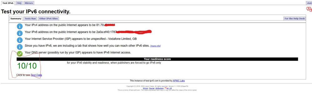

If you need to know what the Hub is at IPV4 and your device is at IPV6 then use the
https://whatismyipaddress.com that will show you, if you need to test then....
Test your IPv6.
When cleared for viewing you will see attached picture.
IpV6 test run from desktop connected through Asus Router on a Vodafone connection!IpV6 test run from desktop connected through Asus Router on a Vodafone connection!

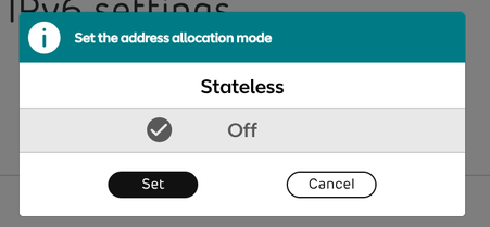

You can't disable the Internet connection side of things, but you can effectively switch of anything on your network using native IPv6 by navigating to Advanced > IPv6 > Configuration in the Hub Manager and changing the allocation mode to off. Note that doing this will cause a brief interruption to your Internet connectivity and it's probably a good idea to reboot the hub after you've done it to get all of your devices to refresh their DHCP leases.
I have my doubts that it's the cause of your problem though. Perhaps you can share some more detail about what exactly it is you're seeing/having problems with?
@bobpullen : Didn't someone recently report that Allocation Mode = OFF is no longer there? It's now Stateless/Stateful/Both!  See Re: How to disable IpV6 Settings on EE Smart Hub - The EE Community
@XRaySpeX - I think the screenshot in that post might be from an older hub or firmware. The option's definitely there because I've started using it myself following recent firmware updates (a change to IPv6 DNS behaviour created a situation where stuff started bypassing my ad-blocking/Pi-hole).
I've also noticed the setting doesn't seem to persist through firmware updates and defaults back to 'Stateless' (at least it did for me).
