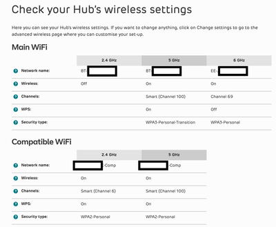

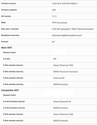

I've screenshot my Hub Manager Tech settings below... grateful if anyone has any ideas????

Looking at your screenshot, it seems that 2.4GHz and 5GHz have an SSID that starts 'BT-', whilst the 6GHz SSID starts 'EE-' How was this achieved? Did you manually change the Wi-Fi network name via the Hub Manager, or did you follow a journey in the EE App (Transfer Devices?) when you first set things up?
Whatever the weather, your hub is in a 'bad' state. It shouldn't be possible to seperate the bands on the Main WiFi, yet you somehow seem to have achieved that.

Thanks: Yes the SSID for 2.4GHz and 5GHz were changed via the EE App following the compatibility process in order to minimise the reconnecting each WiFi device.
What I meant by out of the box is that the 6GHz SSID is the one the device came with, out of the box.... I'm wondering now if the EE App is the root cause, as it has identified the router as the previous Smart Hub Plus type and hasn't updated at any point to reflect it's a 'Pro'. I'll give the factory reset a try.

This is defnitely where my money is at! There are two journeys in the app. A 'Transfer Devices' journey and a 'Backup' journey. Both do a very similar thing though and look to rename your WiFi network name/password to what was used by your previous hub. It's confusing but the idea is that you then don't need to run around changing the Wi-Fi details on all of your devices.
I'd wager that there's some logic that only tries setting the network name for the bands that your hub supports. As your app seems to think you have a Smart Hub Plus, I bet it's only setting the 2.4GHz and 5GHz SSID and completely ignoring the 6GHz. If you use the app again, then I'd suggest skipping the Transfer/Backup bits. You can then use the Hub Manager to manually change the Main SSID name/password if you still need to.
