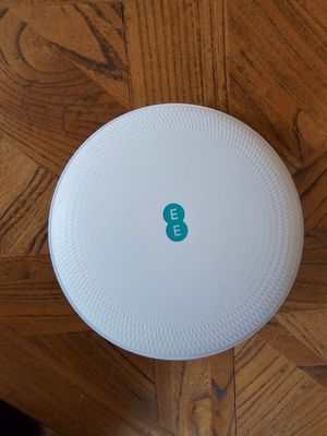

They're the white EE smart wifi discs, will get the model number tomorrow as the photo I took of the back isnt sharp enough, but look like this.
As far as I know only the latest white EE Smart WiFi extender (SW30A) is compatible with the SH+. Most generic mesh systems should also be.
