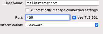

This is a screenshot from the Apple Mail Outgoing Mail Server setting. I assume this is the same for both EE and Voneus (as I'm using the same email client (Apple Mail) for both).

@MartinEllis
My settings are
Outgoing Mail Server: mail.btinternet.com
Port: 993
Encryption method : SSL/TLS
this works fine for 365 mail, but may differ depending on the mail client you are using.
There are more details on the BT Site https://www.bt.com/help/email/manage-email-account/manual-settings/what-are-the-settings-for-outgoin...
Not STARTTLS
Hope this helps.
If you've got these settings correct it can only be that you have "your btinternet email address" or "your btinternet email password" wrong under Voneus but not EE.

@Mustrum : Port 993 is for the IMAP Server, not the SMTP Server.
