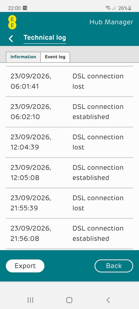

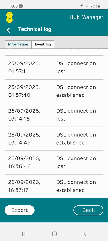

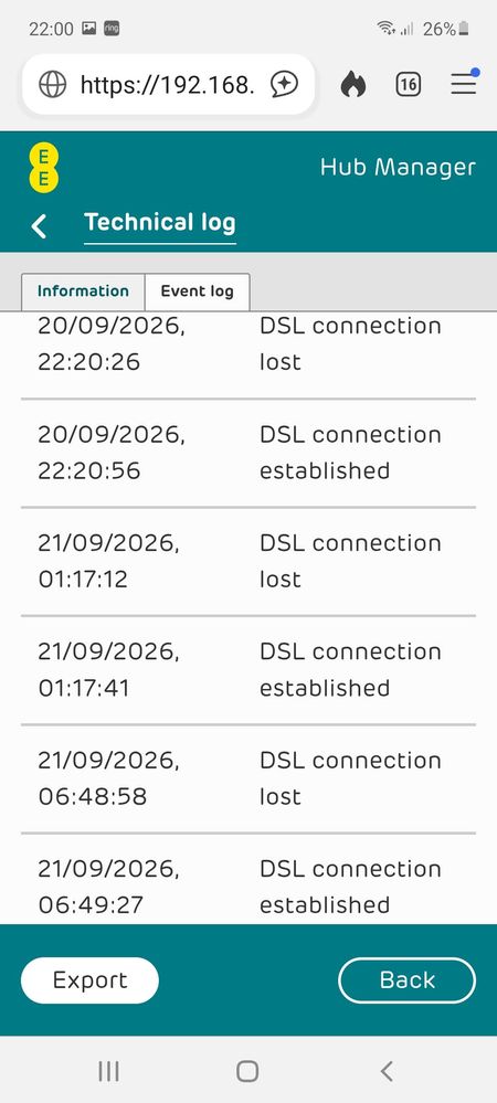

My recently acquired EE 'SMART Hub' router (post PlusNet which was free from issues, and IMO a much more useful router) keeps reporting DSL Connection Lost. I tried EE Chat but since there was not an issue at that moment, nothing obvious progressed. It is definitely the DSL, not wifi. Any advice on how to resolve the issue will be gratefully received. Thanks.

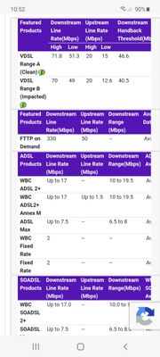

Attached is BT report, I think the screenshot covers detail required.
Socket is a fairly recent BT modern type with built in splitter.
As I have said a few times, previous PlusNet router, which I think I had until June, was performing well.
I have the following conjectures:
a. The line has become noisy, will try and check for this later
b. The EE router is susceptible to mains supply noise
c. OpenReach have been tinkering with the lines.
d. There is a problem with EE supplied equipment, either the router or elsewhere

@mhepplewhite2 Will take a look when your picture get's cleared, the only thing OR has done is move your line to a sogea connection for the DV side off the operation, you can try the noisy connection not sure if it will though as your line voice is delivered DV, but it's worth a go.
Socket test is removing the face plate, but you do need a ADSL Filter to reconnect the cable to a test socket that you see with the faceplate removed, sometimes one in the box or you may have one with the old PN hub. If you have the 5c plate, lower bottom about 1" pinch the sides and pull back to remove, every time the connection get's removed potential to lower your sync speed as the Line manager has no idea what is going on, sync is lowered to try and keep a line going....
Edit:- Picture is cleared so you are stuck at present your above the min that OR has published, only you know how good it was before the change.

Thank you again for all recent advice, much appreciated. A couple of things further:
- I am getting a sense of deja vu. I had a lot of disconnects around last weekend when I recall it was windy. The weather has since been very much calmer. Phone lines are overhead here and several years ago I had an issue where there was wind-induced noise on the line (which could be heard on the good old analogue phone). Quite hard to trace. Also, in another location, had rain-ingress into a pole-mounted JB. Awaiting more wind (or rain) ...
- DSL connection lost this morning at 0813, and I managed to catch the router light flashing orange (SH31B as you suggested) until it sorted.
- internal phone wiring is OK, nothing beyond the master socket.
- packet testing: with a UK or other relatively local server as source, no packets lost.
ATM I think I am in a monitoring mode, particularly to see if there is a weather effect.
