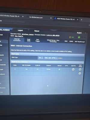

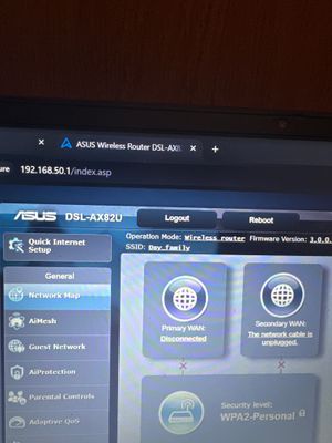

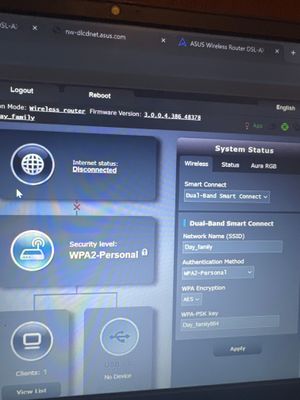

05-11-2024 04:46 PM
I have set up everything like login and password and name i am now on the asus router page but still no internet connection

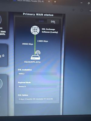

05-11-2024 05:13 PM - edited 05-11-2024 05:15 PM

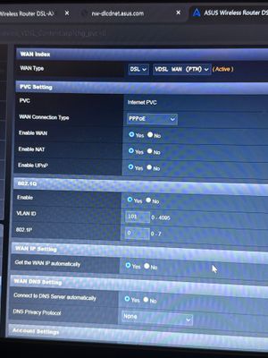

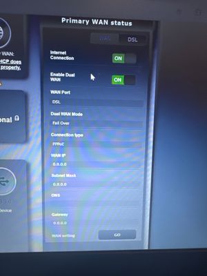

@Kathrynday123 can you click on the Primary WAN button on your first pic, and show the results on the right of the screen?
PS, and then on the DSL tab again on the right of the screen.

05-11-2024 05:27 PM - edited 05-11-2024 05:29 PM
OK, that is showing you has a DSL connection for 30 mins or so, but is not showing an ip address.
You could switch off the Dual WAN is you do not have a separate link.
Edit, can you move down the left hand menu to the WAN tab and post the results.

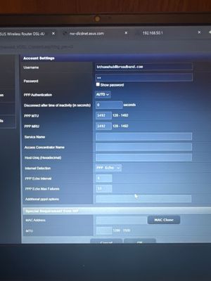

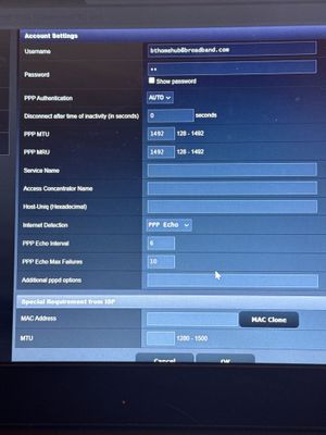

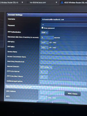

05-11-2024 05:41 PM - edited 05-11-2024 05:43 PM
Well mine looks similar, but I have a green tick on the internet column.
Could you click on edit PVC and post that pick up.

05-11-2024 05:51 PM
OK, seems you cannot spell 😉
Should be bthomehub@btbroadband.com
missed the bt, change the username and then save and try again.
