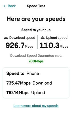

Doesn’t help your situation, but with the same fibre service to the same hub, I’m getting this to the hub, then wirelessly to an iPhone. This is a recent test via the EE app.
The wireless bit is better than anything I’ve had before, and significantly better than WiFi to a cheap Fire tablet I have. I can only assume the capability of the WiFi radio in any wirelessly connected device is a huge factor.
My desktop - and even laptop - days are well over. The router sits close to all my AV kit and that’s all connected via an Ethernet switch, and behaves flawlessly with 4k streaming, although I can’t speedtest it in the same way.
As I say, it’s no help, but does show what’s do-able.
