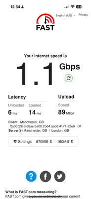

Hi. We’ve had this package about a month. The speed at the extenders will always be slower than next to the router. Your device should switch to the nearest point as you move around the house. I’m sat here next to the router but my phone is still tethered to the extender in my loft. Getting 320mbs. Switch off WiFi, switch back on and getting 1.1gb on wifi. We have 3 discs as it’s an old house.
