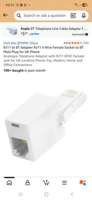

Ok so hopefully this I've bought will work instead of the upstairs filter. Then I have only 1 filter downstairs
@gazmix_1973 Your picture has to be approved for viewing, just say what you have bought.

It's a rj11 to BT female adapter. The broadband cable can go into it and the male BT plug goes into the female BT plug on the carpet. Connects like the filter but isn't one
@gazmix_1973 Then plug it in just now, you should have no problems at all using it, your ADSL filter downstairs is protecting your voice line currently. Please get this into your head, come Wednesday when OR or a Contractor for them comes you will have NO FILTERS WHAT SO EVER, hopefully your connection works and the speed hit is not too big.
Hopefully your gender is wrong as it's a RJ11 to a Male BT phone connection.

It's off Amazon. Coming tomorrow. So this will work and I then only have one filter downstairs at the master socket.  It says it's 4 wire female socket.
Rj11 to BT adapter rj11 4 wire female socket to BT male plug for UK phone.
@gazmix_1973 Only needs to be two wired, but the four wired is fine. Just unplug your old and stick the new one on.
Your change is happening on Wed is that correct? Expect a few hours down while the Engineer sorts it all out.
Link the Amazon you have done so i can look at what you have purchased.
