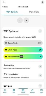

@JimM11 My spare router did not update last night. I am beginning to suspect that the App Version is the important bit as it gives access to WiFi optimiser.
Next step is to switch my extender back on which is on the later firmware version.

@JimM11 Having left the router on for a few days I am convinced now that if you are on
FW: r3.8.24-R-1531355-PROD-1
You will not get for whatever reason
FW: r3.8.26-R-1595999-PROD-1
I currently have a Router on the earlier firmware and an extender on the later firmware and both happily coexist
