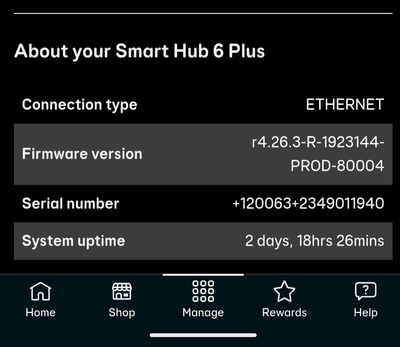

The firmware version is r4.26.3-R-1923144-PROD-8000
As far as I can tell this is not the latest firmware but I don't see any options to update firmware.
@Hex93 If you have the EE Smart Hub 6 Plus version then the latest is below, not sure what you have there. Only EE can do FW updates. Possible what you are posting could be an EE Smart Wireless 6 Plus extender if you have one off those?
FW: r4.26.3-R-1923144-PROD-83002 and the gui is at App version 3.14.5 12/06/2026 OP Posted
That's bizarre. The number is straight from my EE app which is linked to my smart hub. I don't have a WiFi extender so maybe it's time for me to get in touch with EE in that case? Is it possible this is the reason for the patchy teams calls?

@Hex93 It is but it's also one off the very first version's off the EE Smart Hub 6 Plus, so your PROD-80004 may just be correct that way, difference is that it only has a 1GB/s wan port correction which is fine for operation on a FF900 connected ONT.
You will see a couple pictures from the web Manager Interface that shows the FW version differences that the user had so he did compare them. FW confirmed ending at 80004......

Hm have switched it off for 10 mins and back on and it appears that firmware is the same as before.
