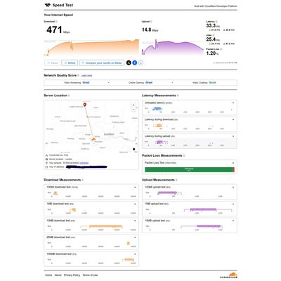

@Nothanks15 While your posted picture is getting approved, you went from the old copper fttc to now on a FF500 connection and going to assume you are using the EE Version off the hub, although both are identical.

@Nothanks15 You need to explain what, your posted cloudflare is NO WAY near the 500/70Mb/s that a FF500 connection get's. You say Tp-Link is that powerline, you can forget about that, get it switched off for testing....
Only ONE connection a PC or a Laptop Ethernet connected to the EE Hub, all wireless wifi devices off, nothing to interfere with the test, You want and need to get like my posted picture on the 500/70, are you sure the profile has been upped by EE for you to the higher speeds, sure does not look like it from your posting I am also 25 miles south of Glasgow testing down to the sky server's via London.

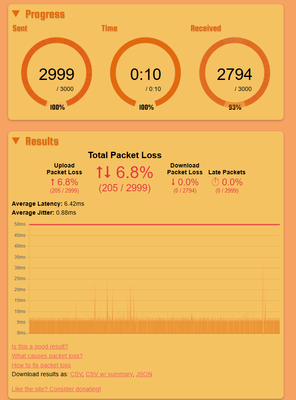

our issue is specifically upload with streaming to twitch that was working with multiple other computers on the network just before the switch over then suddenly isn’t working after the switch over. Tests aren’t really showing the extent of the issue - this says 1.2% packet loss but in practice it’s closer to 8% now

when the picture clears you’ll see we reran with nothing else connected but one pc, wired directly into the (ee) hub. Download speeds much better, but we didn’t care about them.
upload speed has increased too according to that test, but we have run lots of tests in the last few weeks and they vary so much.
for example I think this test is specifically based on streaming (which is where we are having issues) and looking at lost packets that would cause lost frames:

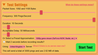

@Nothanks15 What is the ping packet tester you are using, let me know and i will try and post results using same values as you have applied.
It’s packetlosstest.com
(settings from the preset drop down for 1080p game stream)
