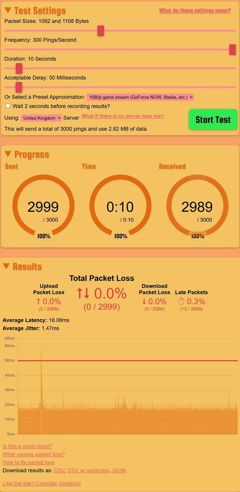

@Nothanks15 Wireless laptop test below. Connection through a Asus AP with a wired backhaul to the Main Asus Router!

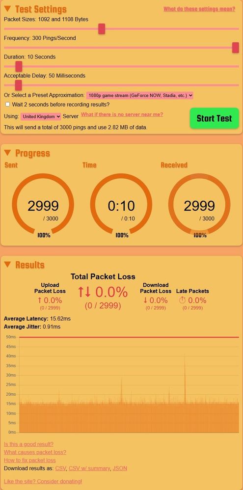

@Nothanks15 Same again on Ethernet desktop.

@Nothanks15 Did the two test's and as expected wired way better than wireless, trust me my gear is good, FF from OR is good, but it is currently on sky just now until wed when transferring to vodafone!
It's kind off reached the stage were your upload does appear to be in the toilet, so apart from setting up a pppoe connection on your computer, connecting that direct on the ONT and bypassing the Hub altogether and then testing out the fibre connection that is were it is, you may just have a bad ONT, bad splice on the Fibre or even a bad Vlan in the exchange so you are going to have to convince EE or OR whoever gets in front off you at the time. Real tricky one, good on fttc, bad on fibre, fibre appears to be the issue, as i say EE connection for me was good on both copper/fibre, been fine now on sky for 13 months, and going to vodafone wed.
