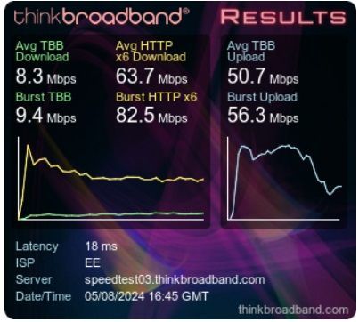

This is my result from think speed test. As you can see single threaded download is the same as my other results.. interestingly the multithreaded ones do increase but only at a factor of threads. Its like single connections are being limited but the line bandwidth is fine... *shrug*
