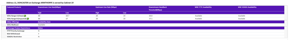

On the EE Availability Checker it shows some Houses on my Street have Full Fibre available and some do not.

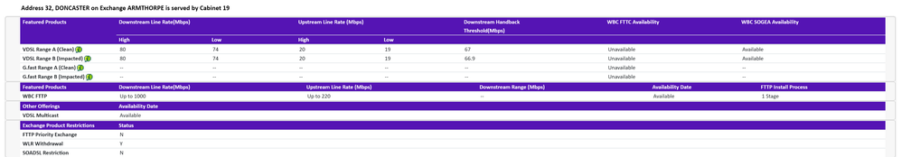

This is the Table for my Address:
And this is the Table for the House Opposite:
As you can see, Full Fibre is shown as available for the House Opposite but not for me, or any other Odd Numbered Houses on my Street.

Now, this is the Table for Number 32 which is opposite me:
32.pngThis is the Text from below the Table:
Our records show the following FTTP network service information for these premises:-Single Dwelling Unit Residential UG premises served by 2.5 Inch plastic duct 56.
FTTP is available and a new ONT may be ordered.

Since the Uploaded Images were dissalowed, I have Re-Uploaded them here after removing the identifying information:

@Kncowans    thanks for the update, the key info from text below the table is:
Alas that info is not shown where you can't get FTTP - so is there a difference on how your current broadband is delivered? Is it also on underground ducts or is it via a pole?
