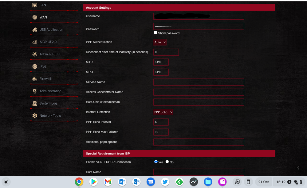

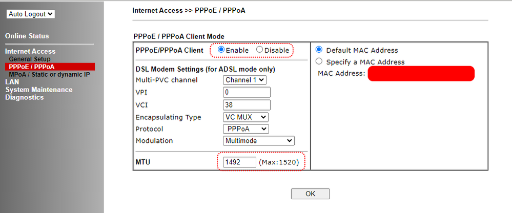

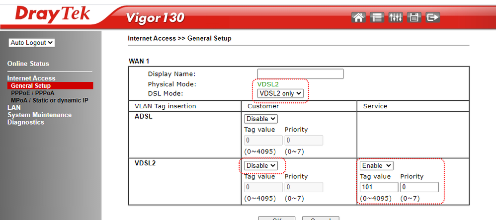

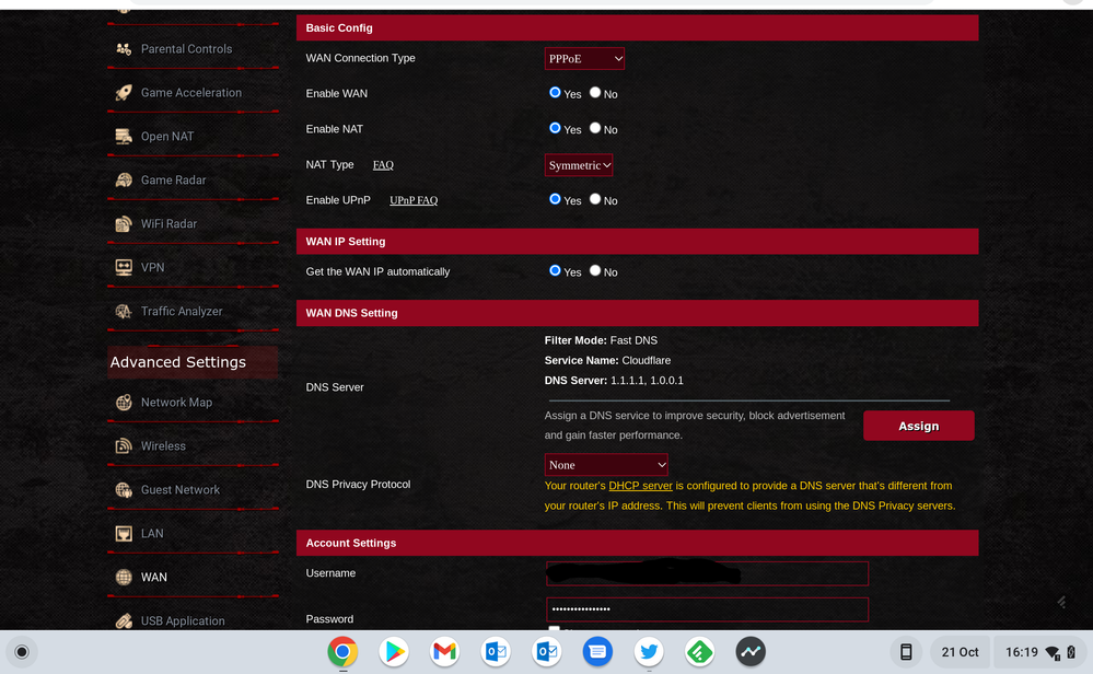

Used my modem and router from TALKTALK now moved to EE Broadband and configured settings as per the screenshots. The PPP Authentication is actually set to CHAP tried auto
The router shows not connected with no IP address, when I go to the system log it's showing waiting for PADO packet and the wan interface appears to have a 169.254.x.x (apipa)
is there a trick to get it to work ?
general_setup.pngpppoe.pngScreenshot 2022-10-21 16.19.30.pngScreenshot 2022-10-21 16.20.00.pngScreenshot 2022-10-21 16.20.18.png

mustrum went for the full fibre vdsl. When you log onto the modem there is no connection to ee at all, just sits on training then ready. Think it's at the physical layer before the authentication can begin. There is no line speed or SN info nothing, and the router status log keeps sayig "waiting for PADO packet" every minute or so but no IP address. work from home so need my mesh wifi back, they tell me there is a 14 day cooling off period so I have till 4 nov to decide

The Draytek modem gives you some info through the GUI but there is a command line tool where you can get more info. It's just not seeing anything on the telco side. Modem goes from ready to training but sees nothing, no snr no packets sent received and the router just kicks out waiting for PADO packet every minute or so.
Wiki has a good write up and says as part of the PPP protocol the client sends out a PADI packet with it's MAC address but it's not getting the PADO reply. It's like the DSLAM is ignoring my own modem.

Yeah tried those settings and PPPoE as well as PPPoA

Tried disconnecting the new EE router for over an hour then put the old draytek back but still the same, it trains but no line info at all, therefore, the PPPoE authtication is irrelevant without the physical done first.

Plugged the new vigor 167 in and it was working out the box, connected to the router and that was setup as per the first screen with CHAP auth and username password from EE.
