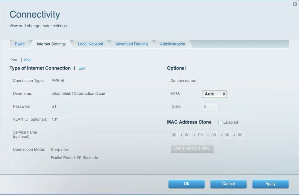

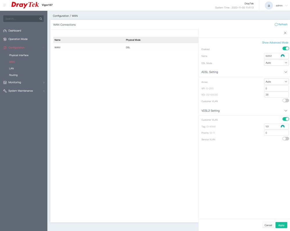

Still struggling here. I have a Draytek Vigor 167 modem configured as per:Vigor 167 settings.jpgAnd the Velop MX4200 router configured as:
Linksys Velop internet settings.jpgThe DSL light is steady on the modem, but the router is still not getting internet. FTTC service from EE. All I have changed since it was working last with Vida is hte DSL username and password.

@StigB  I find your pics hard to read, but you appear to have VLAN set to 101 on both devices, it should only be on the modem - switch it off on the router and see how it goes.
The settings in the link assumes you have an inbuilt modem on the router, but where you have an external modem then you need to full fibre settings.
Edit PS if still not working remove the passord on the router.

Thanks - the VLAN issue was indeed the problem - all working now!
Many  thanks indeed - really appreciate the help.
