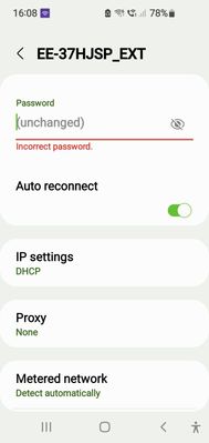

I have followed all the instructions but cannot connect.
My WiFi network recognises the extender, but not the password. This is supposed to be the same as my network password, but will not work.
it's been suggested that it could be something to do with the EE Router and possibly needing to verify the password, but I'm not sure about this.
Any help would be welcome.

Show us the msg not recognising the pwd, but hiding your pwd..
 this is it.
I'm using the Tether app. The extender appears to be on seems to be on  the network list.
I've also tried connecting with WPS, but nothing happens
Thanks

@colloB RE330 depending on which Smarthub you are using as you do not say, but the RE goes as high as WPA2-PSK mode, so have a look at what is set on your Router with the SSID you are trying to connect to!
