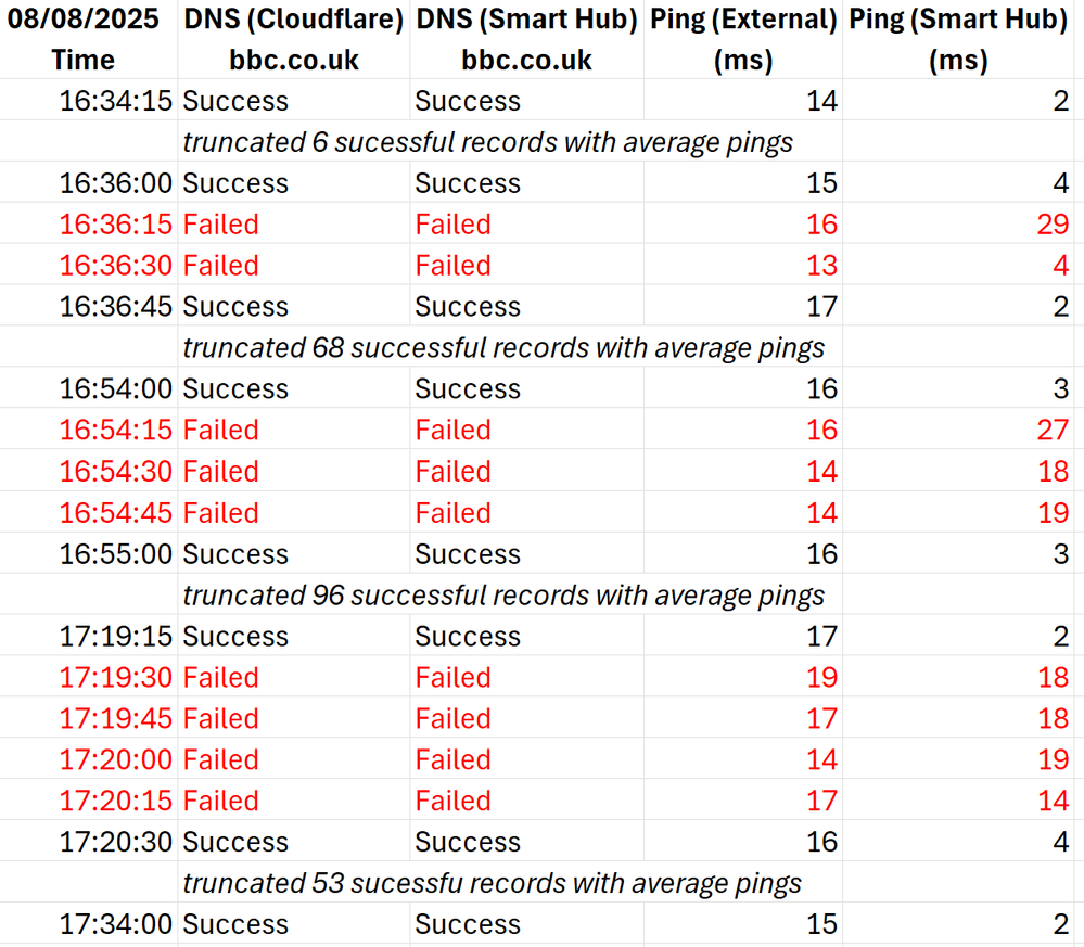

I've left a script running for an hour which in parallel does the following every 15 seconds:
  • DNS lookup for bbc.co.uk using the Smart Home Pro resolver
  • DNS lookup for bbc.co.uk using Cloudflare's 1.1.1.1 resolver
  • Ping the Smart Home Pro (average of 4 replies)
  • Ping bbc.co.uk (average of 4 replies)
This was run from my laptop using 6Ghz Wi-Fi 7 sitting about 5 metres away from the router while the connection wasn't being used at all for any other reason.
There was quite a bit of data, but I've cut the vast majority of it out and been left with the following:
This shows at least 3 periods during that hour which DNS requests (through any possible means) completely failed. It also shows a markedly increased response time from the router during these periods, whereas somehow the response time from external addresses remains the same.
I could run the script for longer but I'd need to set up something to properly parse the data, but I don't think we would learn anything new from doing so.

Really useful data, thankyou.
Someone else said that EE tech are actually analysing this thread, so this stuff is probably invaluable for them finding the problem.
I've gone back to my old router, so I'm paying for 1.6 whilst enjoying 1.0 speed internet.
So you helping out like this, especially if it expedites a fix, means a lot.  Thanks.
EDIT - and your pings look exactly like my real life experience - like, you're accurately describing exactly my symptoms.
