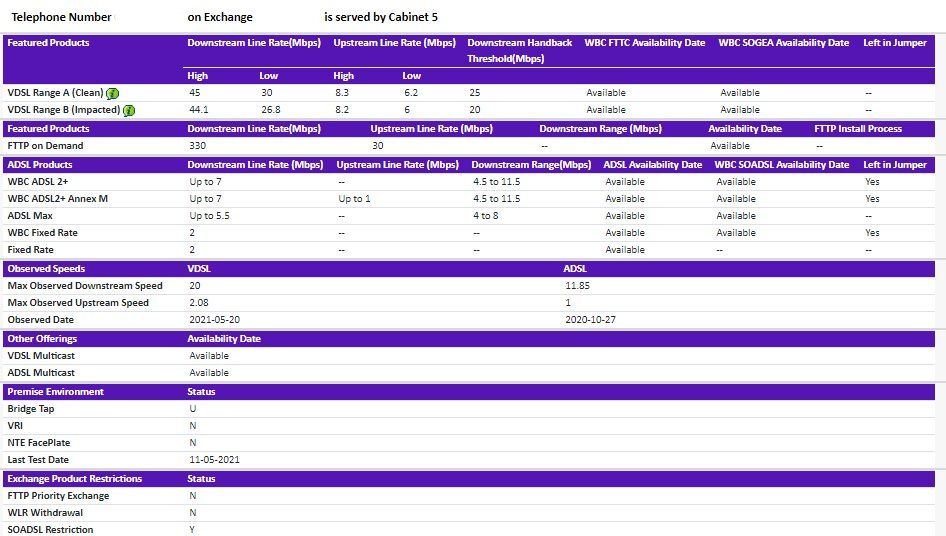

Here's a post of some logs over the last few days and a photo from the BT Wholesale checker website (I've removed my number and exchange for privacy etc).

@PTG your pic will appear after a mod has approved it.
