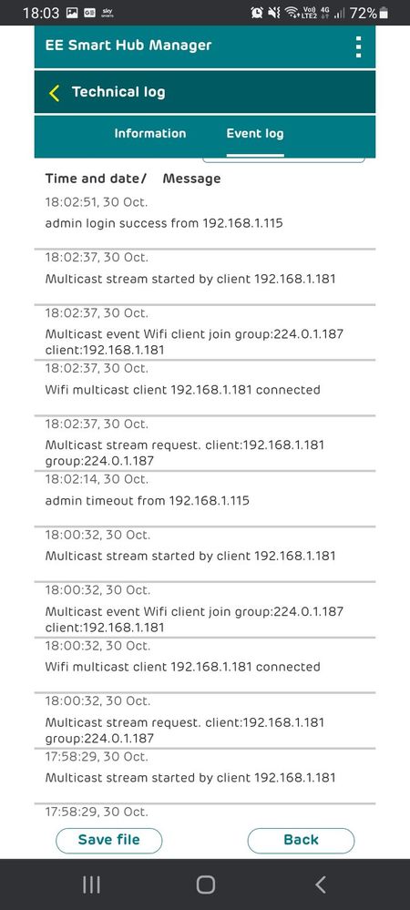

Unsure if I have done this right?

Sorry, @Mikejb73 , that's not the router stats, which are most important to know. Login and follow exactly the route: Advanced Settings/ Technical Log/ Information (not the Event Log). Obscure your names & any numbers in the BB Username & also the SSIDs.
[mod edit: please do not post personal information such as serial numbers on the public board. Thanks!]
You may be better off putting some words around this as it can sometimes take a while for the Pictures you've Posted to be approved.

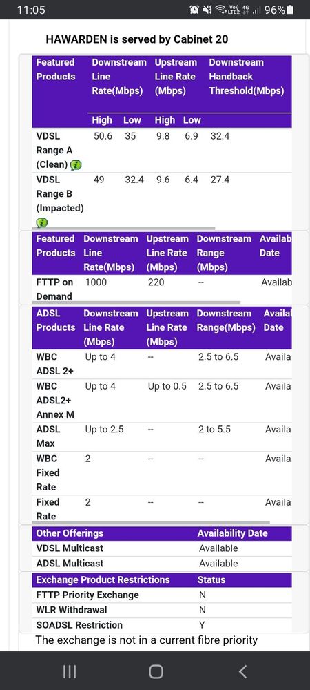

Thanks! That's slow! Now for #3:
What does BT Wholesale Broadband Availability Checker estimate for your phone number? Post just the whole table and the line above it, blanking out your phone number. If it doesn't recognise your phone number or you don't have one, use the Address Checker, not the Postcode Checker.
Hi,
Extremely slow isn't it. Please see below from BT wholesale site.
