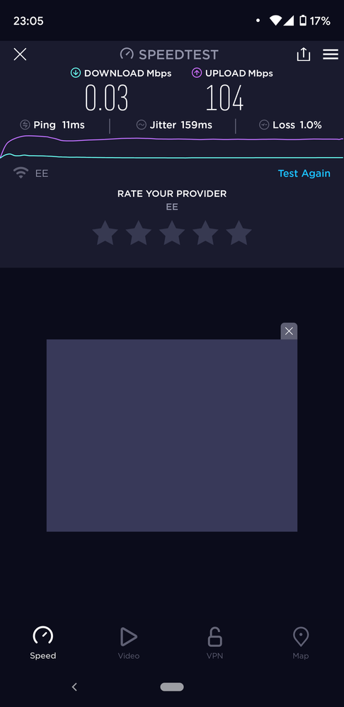

Edit: forgot to mention, I did a speedtest (shown below) this evening when I noticed it not working. There was 0.03mb d/l and 104mb u/l which I found very odd.
