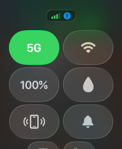

this worked. 👍
Called EE - they added the add-on & 10 mins later 5G appears on the watch.

This week I travelled into a 5G Standalone area near me for the first time since getting the 5G Standalone add-on added to my Apple Watch Ultra 3, and it connected to 5G Standalone with no problem.
