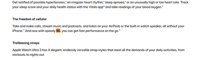

Frustrating!  Especially when they list this on the description.....
And the caveats listed say that it's not available on all networks or plans.  But as you're buying from a network......

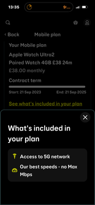

@Yatesy83  my ultra 2 is on a 5G tariff and I took this out in 2023 when the 2 was first released

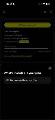

Mine doesn’t show 5G on it. Surely to be connected to the best speeds it has to be connected to 5G. That’s my old plan just took out a new one.  
