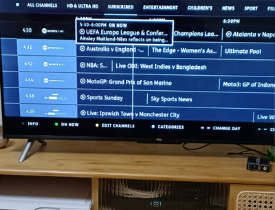

Good morning,
I am Mike and I have been with BT/EE, TV, since the beginning, mainly for
sports, while surfing the Electronic Guide of the box, I find some anomalies,
also when attempting to go to some channels.
TNT sports channels, I can only watch on HD, when I tried to go to TNT1,
normal channel, I was informed that I will be charged £20, these are not
listed to me in the subscribed list, same with most Sky sports channels,
which are all listed as subscribed.
I find this strange, I do know that I would need to pay for Sky sports, but
why are they listed as being subscribed?
The reason that I was trying to get TNT1 normal, was because the Optical
to Digital headphones were giving out a high-pitched squeal on the HD
and I wanted to try the other channel.
Thank you for reading this and hopefully explaining to an Old Man what he
has done wrong.
Mike.

This picture shows you 430 to 439, with gaps, I cannot get
any Eurosport, I did before, but that has stopped, I think since
it became EE TV.
Another thing, that I have noticed, when watching TNT 1, the
message at the bottom of the screen says, "More on Discovery
Plus", when I press the red button and go to Discovery, I get an
error, "Your Host hasn't given you enough", I can't remember,
but I am not allowed to watch the game, if I open Discovery App,
I can watch any game, maybe the software is corrupted, I was
getting strange things a couple of weeks ago, mainly to do with
Guide, sparse information or no information, or you can't watch
that recording, I just unplugged and started again, had to do that
a few times, but not lately, but this is a new box late last year.
Mike/.
