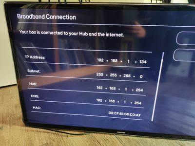

I also tried connecting an ethernet cable from the mini box to the TP Link - after doing this it said the box was connected to the internet (see photo) but no channels were available

I’m waiting for someone at EETV to moderate the image so we can see it.
My hypotheses at the moment are that you have overcome the 2.4GHz problem by using a further Ethernet cable, but you aren’t getting Multicast, so no channels will run.
But what about starting an app, such as Now or Netflix, on the Box Mini? If you now have a connection, those should work, at least, as they don’t rely on Multicast. So please try this, and report back.

Hi, thanks for your reply. I've just tried apps and they do work, if the further ethernet cable between the EAP115 and mini box is connected.

As I surmised - you have a connection, as shown by the apps working, but not multicast, as shown by the live channels not working.
