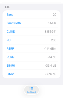

I have this as my signal info if anyone is able to tell me if this is very poor statistics.

Just to add, after a quick google I think the higher the -SNIR the poorer the reception.
Two other phones on EE at home have much lower numbers which suggests signal issues with the phone maybe.

Those two phones you've screenshotted are connecting to different frequencies/radio carriers.
On the left is using Band 3 1800Mhz and is getting what I'd loosely call a weak, but quite usable signal. On the right is using Band 20 800Mhz and is getting close to edge of cell.
