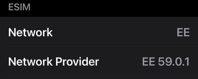

I’ve moved to iOS 18.1 public beta 3. I received a text from EE.
Before that, my network profile was EE 59.5.1
And since the profile update it’s now EE 60.0.1
And I now have the capability to enable 5G Standalone.

Interesting. I'm still on 59.0.1. Maybe that's why it's greyed out for me. Is network profile tied to what version of iOS you're on? If so, I'll have to wait until iOS 18.1 is out of beta.

@stoli412   I’m still at 59.0.1 myself.  OS 18.0.1
