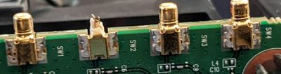

I've been following this thread and was hopefully going to be adding that after TSG installed the antenna everything is great...  Well it "was"....  Then I moved the router not a foot to one side of the shelf it was on, not realising that the antenna cable was essentially resting on the shelf too so taking any strain.  Think you can see where this went!!
That is literally from the cable falling off the shelf, I heard a thump thought the router had fallen but the cable was on the floor with the remnants of SW2 still in the adaptor!!  Many expletives have been said and I've just spoken with Tech who say it'll need to go for repair (I got it in June..) with estimate being £40-200 for repair or if it's beyond repair "from" £140 to get a new one.
I have to agree with the comments on here that they are just too flimsy for "general" use.  Hell my only experience of these type of connectors has been wifi in laptops when it's literally connect once and it's protected by the rest of the laptop!  Assuming I get it repaired although the TSG chap was happy with the basic adapter I think I'll try and get some fly lead style would they be fine?

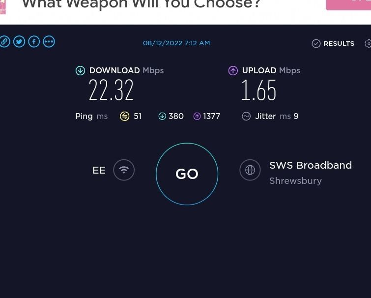

I took a note of the other 3 antennas servicing the area I am in. I pointed it to one that is furthest away and got this result Screenshot_20220814-065215_Speedtest.jpg
 Which amazed me. I don't know if the signal strength is any good but I am happy with the speed. I will tweak it a bit more to see if I can fine tune it.

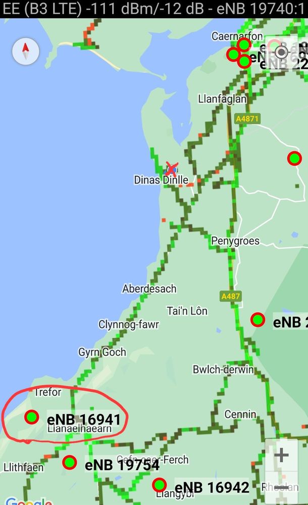

So this was the first mast
 X is my location.

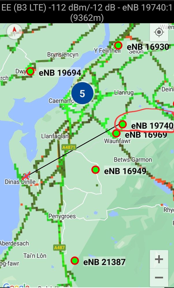

This is the mast I am currently connected to

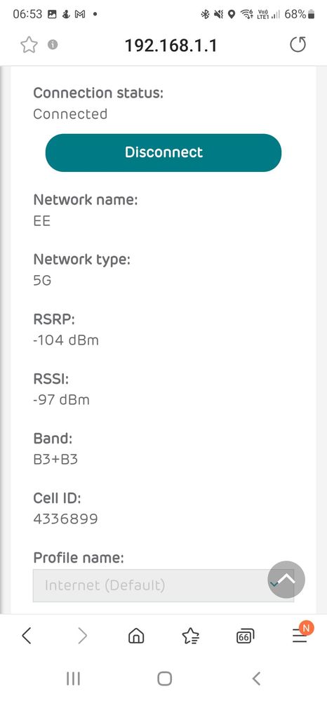

Couple of pointers for you, the Router is Reporting 5G, but the Signal Info is probably only relative to 4G so bear that in mind, the Signal info to watch is the RSRP which is -104dbm (reasonable but could be better) because this is a Negative Value then a lower number is better, ie, -99dbm is a better Signal than -104dbm (+5db more), the B3+B3 reports you are using CA (Carrier Aggregation) and you are using Cell ID 436899 which calculates at enbid 16941 which is what you have confirmed, so to recap you logged into 16941 Sector 3 North East and are using 1800mhz+1800Mhz CA (4G+).
Also worth pointing out that that site probably isnt providing 5G your 5G Signal is coming from another Site so now you have the fun and games of moving your Antenna around to pick the best 4G and or 5G Signals vs Speed, bearing in mind that the Router only seems to be reporting 4G Signal Info and the 5G you have to work out yourself using the Routers 5G Status and potential 5G Speed.

Update on my router: DPD picked it up (so god knows if it will get there!) Just waiting to hear how much the repair will be.  Still fuming about it but it's happened and I'll be using flexible tails on it when it comes back not the short adapter which I had.

You might want to try a cable in port 4 and port 2, they were the ones the TSG installer used and gave me the best signal.  The way they are labelled is port 1 is the one closest to the int/ext switch with port 4 being at the top.  Please if you haven't already get some flylead ts9 to sma and maybe find a way to stop the damn antenna cable dropping and putting all the weight on the painfully fragile ports!  The pictures I posted above are the result of the antenna cable dropping!
