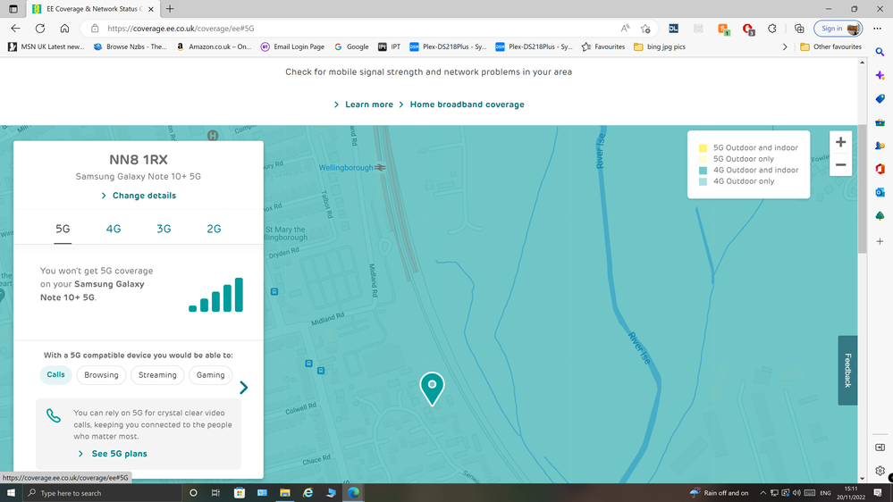

IF YOU CHECK ON EE COVERAGE CHECKER IT STATES WHEN I TYPE IN MY POST CODE AND DEVICE NAMES WHICH IS SAMSUNG GALAXY NOTE 10+ 5G, AND HUAWEI CPE PRO 5G, IT COMES UP WITH BOTH WON'T GET COVERAGE ON 5G, if you test it from your end and type my post code NN8 1RX FOLLOW BY THE 2 DEVICES i MENTIONED THAT I'm USING YOU WILL SEE THE INFO IT REPORTS BACK.

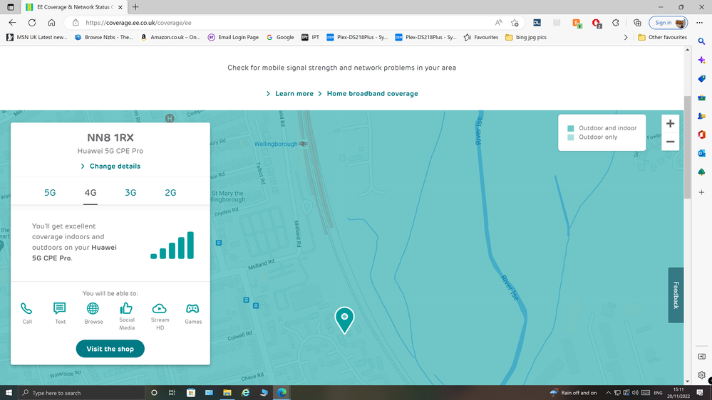

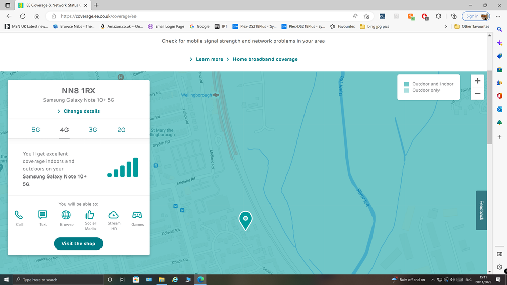

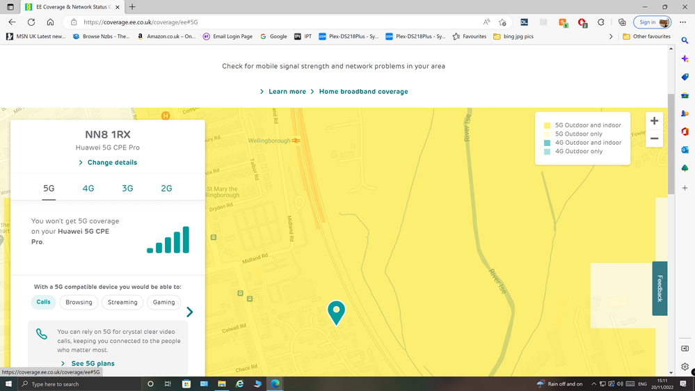

Sending couple more Screenshots of when I check on EE Coverage checker to see if my devices will get good 5g coverage have a look to see what you think to me they are both 5g capable devices and well-known and the Huawei CPE pro 5g, EE was using this before with their services. as you can see, I get great coverage for 4g on both devices but not for 5g surely EE coverage checker is not, correct ?? yet both devices report that I am connected to 5g service??

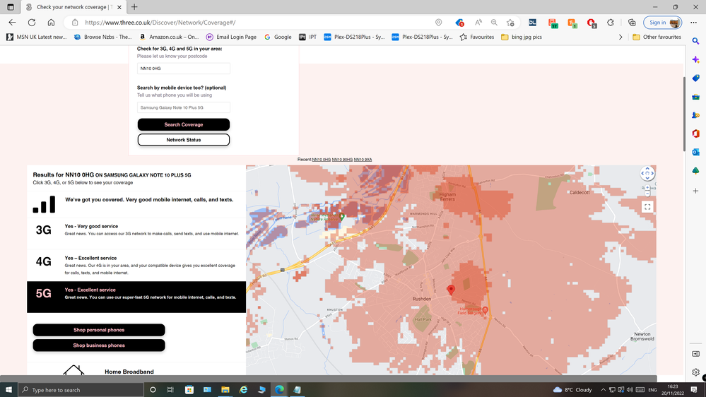

Yes, went to the link you sent definitely issues with their EE coverage map no way is this 100% correct
They need to get this fixed, as a lot of customers will check what they can get , especially if there device is a 5g device brought in the Uk and the coverage map tells them they won't get 5G coverage they will probably go with Three mobile and lose a lot of customers due to this, just checked on Threes coverage checker and using my Friends postcode with my Samsung galaxy note 10+ 5g device and reports It would get Excellent 5g service, but just shows you again EE coverage checker is not right, I used my friends postcode and my device name because I can't get 5G with Three on my mast at the moment they haven't installed it yet in my area and just to show and compare both EE and Threes coverage checkers
20-11-2022 05:13 PM
Chris
Forgot to say earlier when I looked at the coverage EE weblink, I noticed you checked this device 5GEE WIFI ROUTER 2020 and you couldn't get 5G coverage in the area you selected, well I've just checked my area with that same 5GEE WIFI ROUTER 2020
AND IT REPORTS MY AREA nn8 1rx will get excellent service, here's the screenshot I did, it might be something to do with postcode area checker ??
