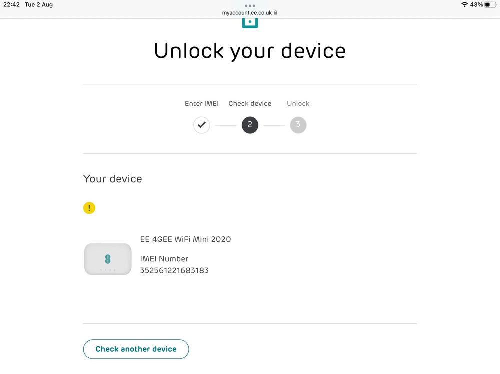

02-08-2022 10:41 PM
I have a 4GEE WiFi Mini 2020. I’ve been onto the EE website to unlock, entered the correct IMEI and now can’t get any further? It’s just showing my device details & an exclamation mark in a yellow circle? I’m assuming this means I can’t unlock it, but not sure why?!

03-08-2022 08:04 AM
Hi @Paul1simon,
Welcome to the EE Community. 🙂
Please could you share a screenshot of the webpage where you get stuck?
Thanks
James

03-08-2022
08:19 AM
- last edited on
03-08-2022
09:02 AM
by
DanielPA
Hi James
Here you go
Thanks
Paul
[Mod edit: Image rejected due to it containing personal information.]
