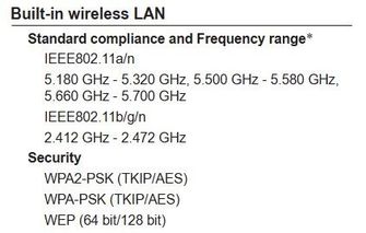

Hi James
Good call checking the manual!  (I should think that at the first place)
However, not much information on "how to connect"
This is the spec I found in the manual.  Based on this, it should work, shouldn't it?
Thanks again for your help

Yes, it should connect over either 2.4 or 5 GHz depending on distance. 2.4 GHz will reach further.
