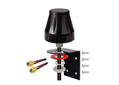

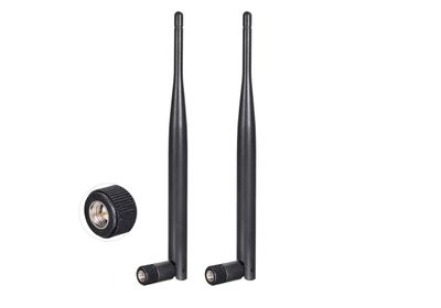

No, you need either the internal “rabbit ears” or an external omni directional 4G aerial (unless you know where the nearest EE site is). Look on Amazon or similar for 4G LTE SMA.
InternalInternalExternalExternal
I have the internal version on mine and have it in a window at the back of the house as that is the only location I can get a decent signal.
You can check your local EE sites on a website like https://www.cellmapper.net/
There are several videos on YouTube that show you how to use the external type.
Don’t forget that the Hybrid Connect tops out at 30 Mbps when in use, so you don’t need exceptional signal, just functional.
