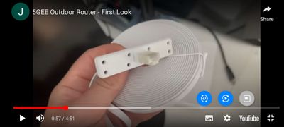

thankyou for your reply is it the end that connects to the outdoor router that i will feed through the hole it is going my floor in my static caravan so i can mount it outside and the end what connects to the outdoor router with the screw holes in does that detach from the ethernet port on the cable thanks just so i know what im looking for
Sorry I don't understand what your mean.
the end of the ethernet cable that you screw to the bottom of the outdoor router is that the end i will have to drill the hole for and push through
Ah, OK, are you saying that one end of the Cable has an  addition Plastic Type Cover or Plate that screws into the Outdoor Router after you have plugged in the Cable in order to Weather Proof it.
hi thanks for your reply yes the EE 5G outdoor router where the ethernet cable connects to has a plate fitted to ethernet port on the cable and im not sure if the plate clips away from the ethernet cable or not to allow access to only drill a small hole or would i need a large one to get the plate through
