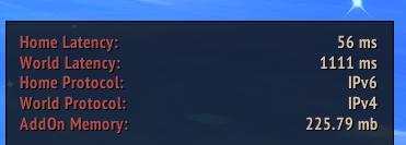

Same for WoW, Ipv6 connections nice and stable, but WoW is not ipv6 exclusive and you end up in a situation like this frequently.
This occurs when the gateway changes and the game struggles to reconnect. It does eventually reconnect but this can be anywhere between 1-5mins just in time for the gateway to change again.
