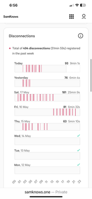

Got the same issue iv used multiple switches and same issue port 2 is the worst I was toy each port can only handle one device and not to use any switch and 30 devices in house was to much for the wifi pro and to turn some off and the ones that where hard wired ie when whe had ee tv thay where the only things that can be directly plugged in to ethernet everything els was to go on wifi even the extender had to go on wlan backhall nearly to say I think I must of been speaking to some one from the  flintstones as didn’t have a clue just managed to get a engineer to come next week
@Cardiffjamesh Would be better if you had some more up to date info rather than months ago data, and Sam Knows is really little bit out of date as they have now completely dropped all there hardware years ago now and can be highly miss leading, but as you say got to start somewhere to see what is going on.
If and when you do get the Engineer visit, just let them do there own thing focus on the task at hand is the best way, stay quite and do NOT offer up any opinions to anything, just gather all the response back from the Engineer visit!
