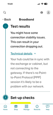

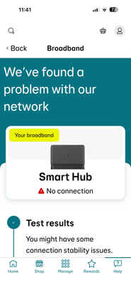

Hi Jim I’ve just run a network check and this has come up, I have no idea what this means? Would this be causing the WiFi to keep dropping out?  
@Hydecrossy Once your pictures are approved and cleared for general viewing will take a look at them.👍
Picture cleared, and YES the home test has failed to get anywhere near your connection so from above the points WHAT are your ONT lights like, and WHAT colour light is shown on your old smart hub if that is the correct version displayed?
Are you defining wifi dropout but meaning the Broadband is ALL gone, ie NO Internet connection. Your Mobile phone IS showing wifi connection on it top curved bars.....

Power and PON lights are solid green LAN light flickering on the ONT box, yes it’s full fibre we have. The hub shows a sold aqua blue light. We do have Internet but it’s keeps dropping out  with the wifi, we do have wired connections too but haven’t noticed any drop outs.
It’s the smart hub plus SH32B model

@Hydecrossy Do as requested by @Leanne_T , it does sound like you only have a wireless wifi issue wither it be all or a few devices with problems, the fact your Ethernet hangs in there you can disguard anything wrong ONT/Broadband wise....
Your SH32B is the FTTP FF Full Fibre only version off the EE Hub. The worry is the test found pppoe issues to your Hub....
