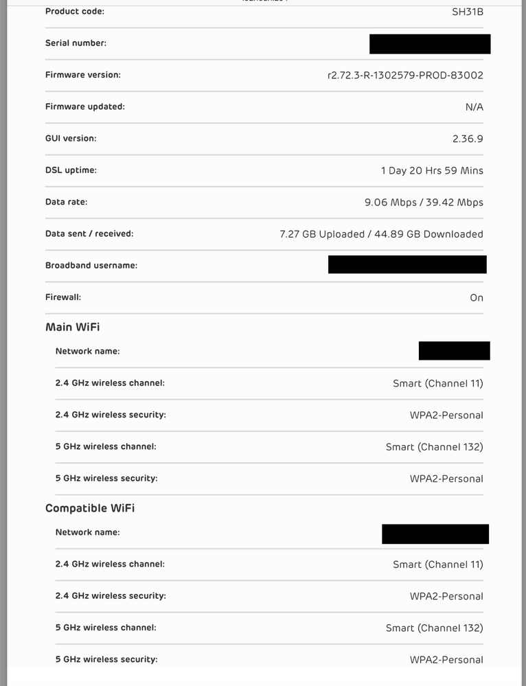

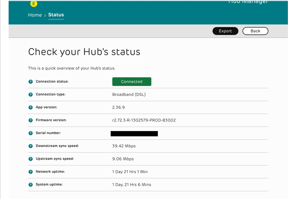

1. Post your full router stats:
  • For a SmartHub: login and go to Advanced Settings > Technical Log > Information. Obscure your names & any numbers in the BB Username & also the SSIDs. Also post the Home > Status page.

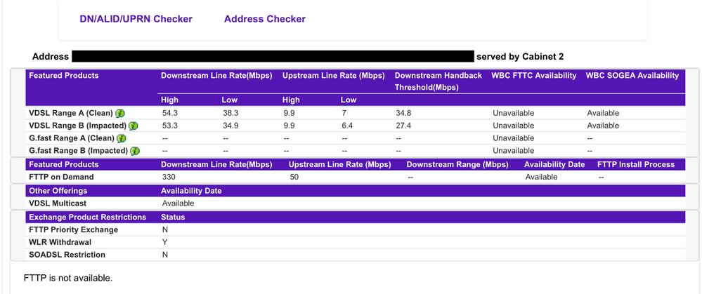

3. What does BT Wholesale Broadband Availability Checker estimate for your phone number? Post just the whole table and the line above it, blanking out your phone number. If it doesn't recognise your phone number or you don't have one, use the Address Checker, not the Postcode Checker.
Thanks for your reply. Here's all the information you requested (I hope!): let me know if there's anything I missed or if I've redacted something I shouldn't!
https://www.thinkbroadband.com/speedtest/1748935397277465555
