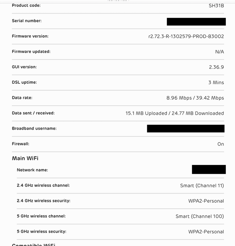

Thanks. Yes, you are getting a sync speed of only 39 Meg, near the bottom of a range where you might expect up to in the 50s.

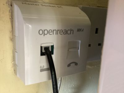

Locate the hidden test socket that is revealed when you remove the bottom half of the split faceplate (2 screws or press tabs) of your master socket. Only do this if you have a split faceplate.
Reboot the router & plug it into the test socket using a DSL dangly micro-filter. Post the full router stats & System Uptime when plugged into test socket.
Is the speed any better?
IMG_0258.jpegDoesn’t look like it’s the split faceplate version, though there are press tabs on the side

It's a NTE5 master socket modified by a Mk4 faceplate which replaced the split. Just press the tabs at the side to remove the Mk4 & you should see the test socket.
Thanks: I've done this and it didn't make any difference to the speed. Here are the stats:
