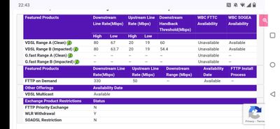

I'm moving from NOW to EE, and the fastest option available to me was Fibre 50 (no doubt due to my download speeds being below 50Mbps, whereas the rest of the properties around me in the cul de sac have significantly faster speeds).
However, my typical upload speeds are about 12Mbps. Am I about to be capped at 9Mbps that's stated for Fibre 50?

Let's see what happens on Tues when the transfer takes place. If the upload speed reduces from 12, which will probably occur, I may well try and phone them again.
It was said by the last guy that it's an Openreach thing, which is clearly not the case, as I currently have no formal limits being applied.
Thanks very much for all your help.
In the beginning there was just FTTC technologically capped @ 80 Meg. Fairly soon after most ISPs brought out a cheaper 1/2 speed ISP-capped 40 Meg FTTC. Then sometime later I'm pretty sure it was BT who introduced an intermediate ISP-capped 55 Meg FTTC with upload capped at 10 Meg.
See Fibre Broadband (FTTC / FTTH) Guide
How fast is fibre broadband?
Fibre to the Cabinet (FTTC) broadband comes in three main variants which offer a downstream line connection speed of 80 meg (80 Mbps), 55 meg (55 Mbps) or 40 meg (40 Mbps), but the actual maximum throughput speed of the service will be slightly lower than this at around 76 / 52 / 38 Mbps. Different upstream speeds are available at either 2Mbps or 10Mbps on the 40 Mbps variant, with 10 Mbps on the 55 Mbps version and finally 20 Mbps up on the 80 Mbps.
So I'm a bit surprised that Sky NOW has a bigger cap, presumably 20 Meg, on its Fibre 55 Meg plan.

Just to confirm that the name of the fastest EE FTTC option becomes "Fiber 67 Essentials" under the "Pricing summary" prior to checkout.
That's why I called it "Fiber 67" on the phone to EE, but when the Guide checked with a manager they were told that "Fiber 67" must refer to Sky - clearly not.
In summary, I just cannot understand why EE would wish to muck about with different speed options, especially since "Fiber 67 Essentials" costs only a quid more a month. I just don't get it really.
Fibre 67, Fibre 72, Fibre 73, Fibre 74, ... it's all the same thing. It's 80 Meg FTTC connection speed with the no. used in its title just the ISP's estimate of the average speed over all its users as longer lines are not capable of reaching 80 Meg.
